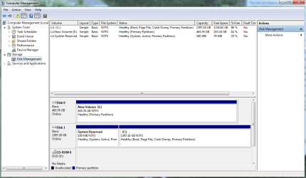

Hopefully, I have been able to post a screenshot of my disk management data.
Looks like there is no system partition on my smaller HD.
What now?

But that screenshot looks like everything is OK. Your system is on the larger HDD as you wanted it and if it works, you are fine.
Except that I still have two OS's on my smaller drive that I want gone. One is win 7 and the other is win 7 old. Can I simply now just delete those. They are taking up at least 24 GB of space.

I don't see an OS on the smaller drive. But maybe the whole drive is an OS with accompanying data.
The Windows.old is probably a folder that you could delete. But no need to do that if you do the next step.
For the OS in that single partition, that is a bit trickier. I would backup all data in that partition that you care to keep. Then I would delete the whole partition (with Disk Management) and make a new partition from the unallocated space to where you can restore the saved data.
If you do not have an external drive for the temporary backup, shrink the C: partition on the big drive and make a temporary partition to hold the backup data. Make it big enough that all data that you will backup will fit.
After saving the data on the smaller drive that you want to keep, I think even formatting it with Disk Management should suffice.
