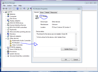

Ok , i installe windows 7 on my HP laptop today & after all instllation was completed & got all the updates etc .. I noticed 3 things & it stated them in action centre also .
1) Im missing my sound card/driver , cause it says im missing it . my sound card/driver is ; CPT5910a, conexant AC - Link Audio
2 ) Video controller i also dont have . The taskbar in windows 7 isnt transparent & thats due to i dont have the video card & other things .
3 ) I need to install my modem driver ? I dont know what that means but please help me fix this !
This is what it says , in device manager ; under other devices
- Multimedia audio controller ( with yellow trinagle/exclmation mark )
- PCI mondem ( with yellow trinagle/exclmation mark )
- Video Controller ( with yellow trinagle/exclmation mark )
PLEASE PLEASE HELP ME !!

Is this a laptop from some years back? Purchased originally with WinXP installed? Possibly with Vista?
These legacy machines are often not supported going forward for other than the OS that was sold pre-packaged with the unit.
It may be quite a challenge to find drivers that are suitable for this hardware, chipsets, video, etc., if it's not directly supported by Win7 out-of-the-box in a fresh install of Win7, or offered for separate download by the laptop manufacturer.
Quite often the Vista drivers can be used on Win7, but there's certainly no guarantee.
If Win7 itself finishes its install with lots of devices NOT installed properly and without having drivers (i.e. having yellow question marks in Device Manager), this is a strong indication that you're probably in for quite a battle to find drivers for the hardware. Better prepare yourself for doom, but good luck trying to seek out the Win7-usable drivers you need.
Either live with the original Windows on the laptop, or upgrade to a new laptop, may be your only options.

Specs on that laptop,
HP 510 Notebook PC specifications - HP Small & Medium Business Products
The only thing available for that laptop from HP are XP drivers,
http://h20000.www2.hp.com/bizsuppor...sId=3316189&swLang=8&taskId=135&swEnvOID=1093
there is a couple of Vista driver listed, but none of them are what you are looking for and they are 64 bit. Try using the XP drivers from HP for those three devices. Yo9u may have to use compatibility mode to get them to install,
http://www.sevenforums.com/tutorials/316-compatibility-mode.html
As far as the taskbar not being transparent and other Aero effects, that isn't going to happen as there are no Windows 7 drivers available for it as Intel never made one,
Graphics — Older Intel® graphics controllers and Microsoft Windows 7* operating system
so the XP driver is the only option for this.

HP 510 Notebook PC -  Download drivers and software - HP Business Support Center - video/graphics
HP 510 Notebook PC*-* Download drivers and software - HP Business Support Center - audio
HP 510 Notebook PC*-* Download drivers and software - HP Business Support Center - LAN/ethernet drivers
Not sure what to tell you for the modem driver, as HP doesn't list one. Better question would be, do you even use it, as in when was the last time you used it for a dial up connection or possibly for sending a fax?

I have an HP 510 laptop which has been running Win7 fine for years with just a 1gb RAM upgrade. It does not have aero, but then it is an old laptop I use on the beach.
The drivers which I have on file which are not supplied by installer are the same as Stormy linked just above. You'll need to download them then rightclick to Run As Admin. If any balk you may need to run them in XP Compatibility Mode and/or browse from Device Manager to their extracted folder in C: root to pick up the driver.

Modem driver is almost always the outdated FAX modem built into older computers. You can disable it in Device Manager.
LAN is for the built-in wireless which works fine here. Even if you use a wire at home it will come in handy if you take it somewhere with you.

heres a screenshot of device manager ;

The PCI modem is a built-in fax modem on old computers - just disable it unless you need it. It is likely included in the chipset.
Those two other drivers are on the downloads page.
Your wireless adapter is listed under Network adapters, likely already installed since there is no device in error there.

Can't say since we can't see what installed Network Adapters you have. How are you connecting now?
If there is no wireless adapter installed yet, you should install it.
