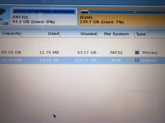

Can you get a camera snap of the Partition Wizard drive map with listings?

Well here is a screenshot from Minitool partition wizard.
I created 2 separate partitions when I installed Linux again so I could still mess around with the other and try and get it to recognize. The Ext4 is where I loaded linux and I formatted the other as an FAT drive, which should be recognized by windows. I will reformat it again as an NTFS but I've already tried that and it didn't do anything so.
Btw, the top one is primary. No Letter is assigned to either partition as well, as it won't allow me to.
Also, the FAT32 drive is set to active while the Ext4 is not.
To install Win7 to the HD, click on the Disk # to highlight it then quick Wipe the HD to clear GRUB corruption from the boot sector.
Reformat the disk with a 100gb NTFS Primary partition, rightclick to Modify>Set to Active, Apply.
