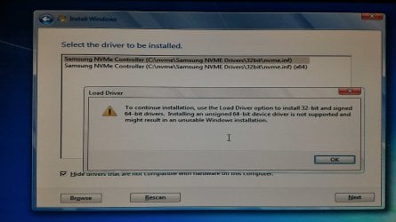

-If I create a bootable usb with the Windows 7 USB DVD tool, the installation starts but fails to accept the NVMe drivers, saying "they are not signed".

The fact that the drivers are refused as unsigned is concerning. Where did you get them?
Best guess is that you need to integrate certain updates (in particular there is an NVMe update, and some driver framework updates) into the install images.

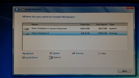

Thanks for the replies all.
The one in the image attached is the error I was receiving before. Now I have been able to follow the instructions and to enter the installation process. The second image I attached is where I am currently.
I cleaned the 950 Pro with diskpart and created a new partition. The system automatically creates two of them: the first one is 100 MB reserved for system, and the second one 476 GB. My question is: what I should do now taking into account that this is a nvme drive? Does it change something from the ahci type?
In another forum I read something along the lines of:" leave about 20% unpartitioned space for over provisioning, or garbage collection". What does this mean exactly? And, above all, is this really necessary and what are the advantages of doing so? These drives are pretty expensive and "wasting" 20% of the space leaves me a bit worried.

The 100MB Reserved partition is normal for Win7. You can avoid it if you want (with a bit of effort), but I'm not aware of any good reason to do so.
Regarding over-provisioning, I thought we were past that with TRIM and other wear leveling technologies. But in fact, Samsung Magician has an option to configure over-provisioning, and for my drive (850 EVO 120GB) recommends 10%. I don't know what to tell you here.

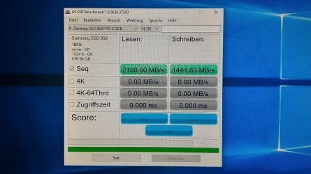

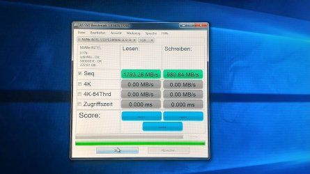

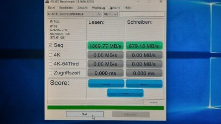

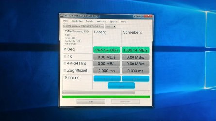

I have been able to install Windows 10 and Windows 7 thanks to your instructions, guys.
I would have a question though, mainly concerning the performances of these two disks (Intel 750 and Samsung 950 Pro): the difference I am referring to is between Windows 10 and Windows 7. The first two images are the speed of the two drives in Windows 10, while the second two are the speeds I obtain in Windows 7. As we can see, both drives are slower in Win 7, particularly the Samsung 950 Pro.
To clarify, it must be stated that in both OS I installed the last version of the relative official NVMe drivers and in Windows 7 I also installed the NVMe hotfix (but the results are the same with or without). Any thoughts on why this is happening? I know Win 10 has a better (native) management for these drives, but I would like to understand better the issue here. I would be also curious to see how Win 8.1 behaves.

I was just told installing to an M.2 card will lower the bandwidth on your video cards.
That would depend on how many video cards and other cards and the CPU the OP is using. The P9X79 Deluxe has 40 lanes even when using the earlier Sandybridge-e processor so he should still have enough bandwidth for one GPU and two M.2 devices on an add-on card (the latter using only x8 lanes).
Yes, I`m sure you`re correct LF :)
Those numbers are off the hook, beautiful :D
