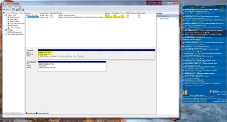

Had this 2_tb HD running for 1 month now, No Problems.
Full format, No Partitions.
