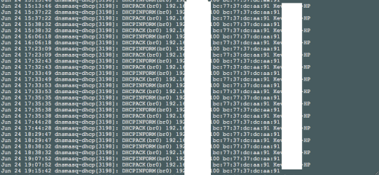

I did some diagnostics, and found something curious that the router told me:
Whatever configuration is wrong with my laptop, it's constantly sending DHCP Requests to the router, literally every few minutes, which is why my internet connection keeps waffling. Does anyone know the origin of this situation?
