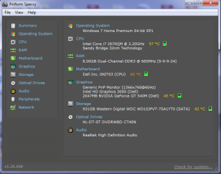

hi there,
i have a dell xps l502x laptop with the following configuration( image attached). i wanted to install windows 2012 and sharepoint server on my laptop as dual boot. would someone please suggest whether i can upgrade my ram from 8gb to 16gb?? if so what speed and which suits??
i rang dell customer support today, they mentioned that this motherboard can only support upto 8gb, not more than that..
thanks alot in advance.

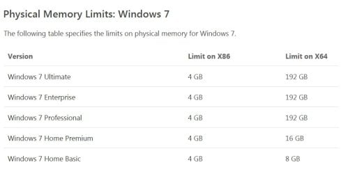

You'll need Windows Pro or better to use more than 8GB.
I don't believe this is true.
I am running 16GB on Home Premium right now.
I believe the limit for Home Premium is 16GB.

Well.....
Well.....
Thank you everyone ... keep keeping me honest!
My apologies, I should have confirmed (I usually post the same sheet gulls posted - shame on me!). I've corrected my post.
