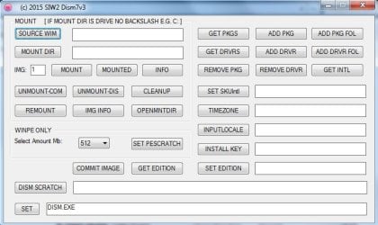

It takes a while to mount wim image , install 200+ updates, unmount the image,.
So if you want to update all 4 ( or 5 for x86 ) images, there is a workaround. Just update image 1, make several copies and change the editions using dism.
Here is a dism gui to make changing editions simple
View attachment dism7.zip

Thank you Siw, going to have a look.
