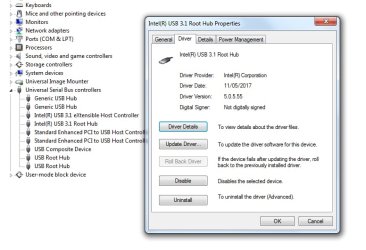

You could use these usb3 drivers View attachment 411785
Not signed for win7, so ok it if that message pops up.

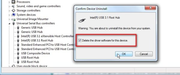

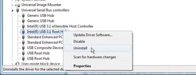

First make sure your mouse is plugged in to ps2 or usb 2 port.
Then uninstall both the usb3 devices from device manager and delete the software.
Then install the 5.05.55 usb3 drivers using dism++.
View attachment Dism++10.1.1000.100.zip
Then in device manager, click the usb tree to highlight it and scan for hardware changes.
