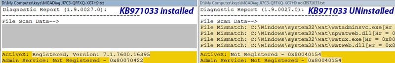

Hi
Both those keys are showing as retail, and good
There are 2 issues
they are both currently Activated but not Registered, pretty standard fix
install kb971033, then reboot twice for it to update the MS validaion servers.
OF more concern
They both contain a 705 entry,
Windows Product ID: 00371-705-7245917-06288
Windows Product ID: 00371-705-7310703-06322
now these were primarilly issued to developers, known as MSDN keys.
and SHOULD NOT have been sold on, they also have a limited number of activations once that limit is reached, and no further activations can be made-- the key will be blocked

There are 2 issues [1] they are both currently Activated but not Registered, pretty standard fix, install kb971033, then reboot twice for it to update the MS validaion servers.
KB971033 had actually already been applied. Out of curiosity I deleted the update, reran MGADiag and compared the results (only showing differences):
Theoretically, the Admin Service should have gone to Registered status with update 971033 so why did it not I wonder. As an FYI, the link for downloading 971033 in the MS KB article was throwing a 404 when I tried to download and reapply the patch. Thankfully I do daily backups.
[2] OF more concern, They both contain a 705 entry,
... these were primarilly issued to developers, known as MSDN keys and SHOULD NOT have been sold on...
This is very useful. I was tangentially aware of an entity called MSDN but since I've not been a programmer since mainframe COBOL/Assembler days I never paid it much mind. I suppose this is a legal grey area (presuming of course that my retail licenses did indeed originate with a MSDN subscriber) -- who is liable, the developer who sold them, the middle-man retailer who may have acquired them in good faith or the final customer who inadvertently purchased questionable goods? Yes, I did wonder about the low price but figured that there must be a market for fully depreciated (from an accounting perspective) software similar to that for fully depreciated hardware. A market for depreciated software licenses my exist but ...
I'm not comfortable in the grey area and am searching for replacements. (Once bitten, twice shy) does this look legit to you (I downloaded the MS volume licensing EULA & it doesn't look like Tralion (a German firm) is doing anything shady)?
