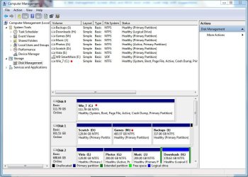

Not sure what you're looking for in the BIOS, but I can assure you that the SSD drive is the first boot drive.
As for the disk management screen, the C drive is active and does contain the MBR,

Again, I fail to understand why WBU is insisting on asking for a drive with not boot records.

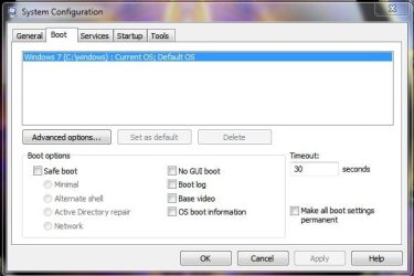

Just in case....

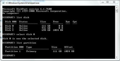

Thanks Cato, excellent find! Yeah that looks like what might be going on here. However I'm a little reluctant to try the procedures as I don't want to give up any more hard disk space on my SSD drive. Also It appears that I don’t have the 100MB partition anyway as Windows never seemed to create one for me as shown in disk part…..

In other words when you restore an image to an SSD drive, it will get the default 63 sectors offset instead of 64kb (or a multiple of 64kb) offset recommended for SSD drives even if this offset was in place when the image had been created. This may result in a drop of performance on certain models of SSD drives after the restore;

Yeah I saw that tutorial, even used it to post my diskpart info. Though it tells you how to align the SSD drive I saw noting there stating an image created by ATI would be aligned correctly during a restore. Sorry.
