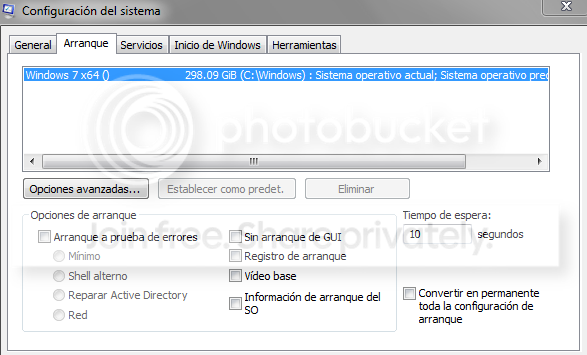

Thing goes like this, i've cloned my drive from a 160gb disk to a 320 one with XXCLONE utility, and since then, Windows has a strange boot, my Windows work on spanish and the boot is in english...
The problem is the next, i know that to fix this, i need to repair boot or something like it, but here's were it comes trouble and makes all the mistakes, the Windows identifier under BOOT sequence is broken, need to show you a picture of the 'Boot' section of msconfig for you guys to understand me
As you can see, the identifier is broken because is says "Windows 7 x64 () 298.09GiB" and i know that this need's to say "Windows 7 x64 (Professional)" the issues of this mismatch on the identifier is that i cannot do any type Repair/Upgrade install with the Windows 7 disk, the same used to install the system... And also i cannot repair the system because the mismatch...

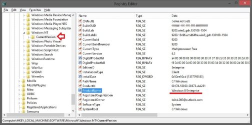

Hello Lincer,
That is only the name listed in the "Windows Boot Manager" screen at boot. It's not what is used to identify the OS.
Instead, the registry location below is what is used to ID the OS.
HKEY_LOCAL_MACHINE\SOFTWARE\Microsoft\Windows NT\CurrentVersion
If you like, the tutorial below can help show you how to change this OS name displayed in msconfig and "Windows Boot Manager" to what you like instead.

Already tried the CBS last night with no good results, actually sorry for the foreign language, it says "Current Operating System, Default Operating System"
