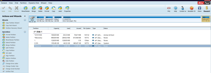

Oh Greg this is what the partitions look like - I have no idea and Gary said you were the person to ask about partitions.

So you'd remove the hard drive and replace it with the SSD, boot into BIOS setup and turn off Secure Boot, Save Changes and Exit. While in BIOS take note of the settings for CSM, Legacy BIOS and BIOS Boot order as these may need to be adjusted depending upon how it behaves during install.
Then boot the Win7 installation disk as a UEFI device. Your DVD drive will literally be named the EFI DVD-ROM so you know the right one to choose.
Proceed with Clean Install Windows 7 creating your partitions as desired, format, highlight the first large partition for install and click Next.
Report back any errors or failure behavior as there may be an additional setting change needed in BIOS. Every BIOS is different so we'll have to see about yours.
If and when you every reinstall the HD, you may or may not need to turn back on Secure Boot.

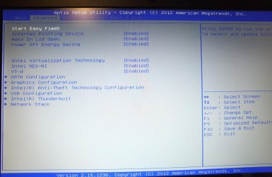

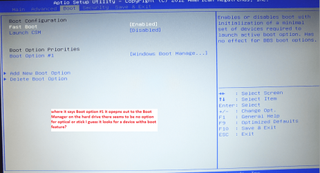

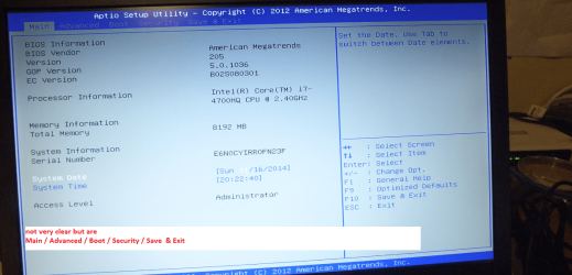

Greg rather a lot of pics but I have never come across aBIOS like this before and I hope you can see the bits I think you were sayingto turn off or not.

Disable Secure Boot Control.
See if that removes the other Secure boot listings. It should.
Then power down, remove battery, hold power button to release residual power, change out HD for SSD.
Reboot with disk in drive. It will either autostart or you should choose EFI DVD.
If required to add DVD drive in BIOS Boot tab, follow your Manual on the Asus Support Downloads webpage for your model.

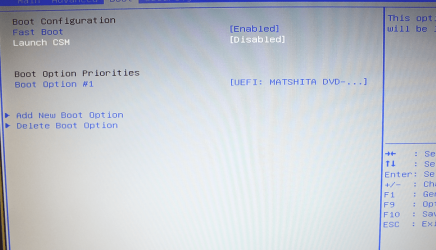

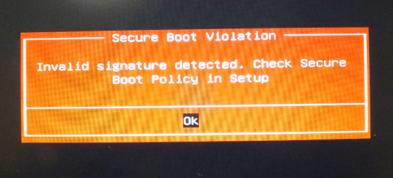

Greg have disabled the secure boot and those other settings didn't come up. I have changed the boot settings but get a red warning that I don't understand see pics.

Update worked it out I think mate the secure boor had switched on again even though I changed the boot option - fingers crossed

I wouldn't worry about the error if you've disabled Secure Boot. Remember to Save the setting before exiting or it won't be remembered.
Go ahead and install Win7 so we can see if you need any adjustments, i.e. Turn off Fast boot to use BIOS Boot Menu so that Windows Boot Manager can be set first to boot, or Launch CSM as is sometimes needed to install Win7 even with UEFI.

OK then Launch CSM in BIOS setup.
Is this a retail DVD or did you burn it?
Did you select UEFI DVD choice? Try the BIOS Boot menu to be sure you can see what you're choosing. You may need to turn off Fast Boot to access it, normally via F8 or F12 key on Asus'.
You are a wizard Greg I turned off the fast boor enabled CSM and am now at the Install now screen
