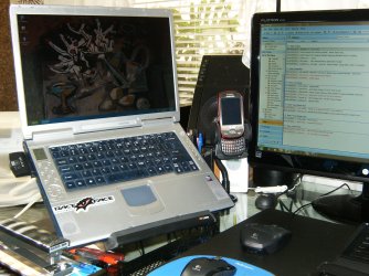

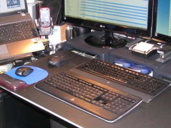

bancosrs, Let me come from a whole other angle. I have had my lappy on coolers of several styles and they do work and I would suggest them for beds and travel. For a desk this combo is tough to beat. Yes there are some adjustable fan style coolers that look nice but IMHO it's more to go wrong as they are cheaply made. So here's my plan Stan you want this stand and then get yourself a killer wired or wireless gaming keyboard and mouse and you'll be in freak'n ergonomic heaven.
Amazon.com: 3M Vertical Notebook Riser (LX550): Office Products
I won't post a keyboard and mouse as they are very personal, many here are going mechanical switches but do find one with back lighted keys and with a good mouse you have the screen up and off the desk as well as the fan drawing cooler clean air and the best ergonomics. Phase 2 or 3 you add and nice 2nd screen and go dual monitor, Wicked !

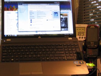

My HP lappy is pure i3, 8gb 1333, SSD business and I can game on it some it flat sucks so I'm not qualified for that question but as far as temps they are as good as any cooler can provide as really the fan style coolers are only drawing air up and making cooler air available to the lappy's intake. They don't seal off the lappy and force air into the lappy. Really all you have to do is prop your's up after running a temp and compare. If you want a powered fan style it won't hurt at all...something like this:

Keep in mind with my style stand it's adjustable but has no fans, all it does is prop the lappy up and leave the lappy's intake open to draw room air in freely. As I mentioned just put some non-skip under the bottom front of your lappy and prop the back up on a box and read your new temps and that's what your going to get ! Clean simple and really there is no silver bullet here as the ambient in the room is what it is but air flow you can control some.
