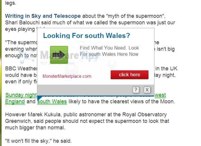

I would suggest uninstalling whatever you just installed.
Did the word "drivers" cause a small popup window when you placed your mouse over it?
Something like this:

Thanks for the tip - I just uninstalled the program. It was Uniblue DriverScanner. The link doesn't cause a popup when I hover my cursor over it. It simply turns the arrow icon into a hand icon. Jeesh but the internet can be nefarious....
