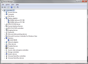

I'm having trouble finding the specs on that particular model can you post a pic of your device manger showing the display device please? I would start with reinstalling your video driver. Your hardware have kicked the bucket though.
