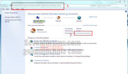

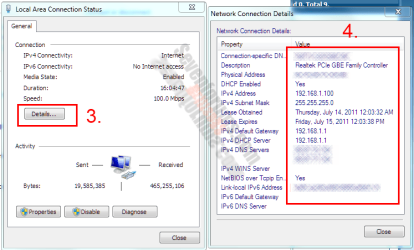

Look at the snips below and follow the numbers. 1 is where to naviagte to. when you get to 4 there should be a lot of numbers there. I have blurred mine out, but your should have some there. If not, you aren'r connected. Click the troubleshoot and see if it helps.
