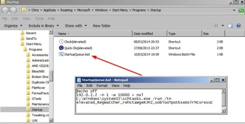

2). Create a batch file to launch the program with a delay and save the batch file in the following location:
%Userprofile%\AppData\Roaming\Microsoft\Windows\Start Menu\Programs\Startup
Example batch file (not for use on other machines):
@echo off
192.0.2.2 -n 1 -w 10000 > nul
C:\Windows\system32\schtasks.exe /run /tn TASKNAME

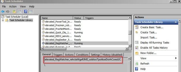

In the above example 10000 (milliseconds)sets the required delay of 10 seconds- use a higher or lower number if needed. Replace TASKNAME with the name of your task. You can find it in Task Scheduler. (Start > Run then type Taskschd.msc then click OK).
Note: You may get better results if you substitute the line
with
ping -n 40 127.0.0.1 > NUL 2>&1
For this test
elevated_RegWatcher_rehctaWgeRJM2_xoblooTpotkseDsirhCsresUC is the task name as shown in Task Scheduler.
Screenshot of Task Scheduler:

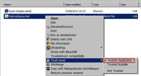

If you have security software on your machine that might interfere with unknown files that attempt to run be sure to set it to trust the file that you created.

Once you have created the Elevated Shortcut get the taskname from task scheduler. In this example I've created an Elevated Shortcut for the process Regwatcher.exe

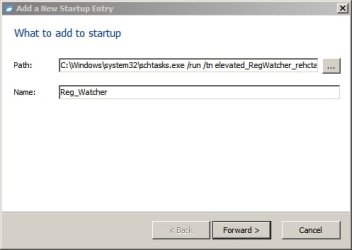

In the window that opens click the "Add" button in the toolbar. Enter the path as shown:
C:\Windows\system32\schtasks.exe /run /tn taskname
If your taskname contains spaces - wrap the taskname in quotes.
Give the Startup Entry a name.

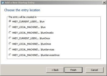

Choose a location for the entry - refer to the registry locations shown in Method 4 of the tutorial here:
http://www.sevenforums.com/tutorials/1401-startup-programs-change.html
Add the desired location then click "Finish"

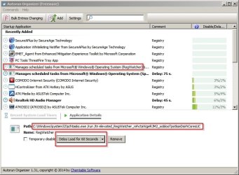

Highlight the entry that you've just created and choose the required delay in seconds. Click the drop down arrow to manually input a delay.

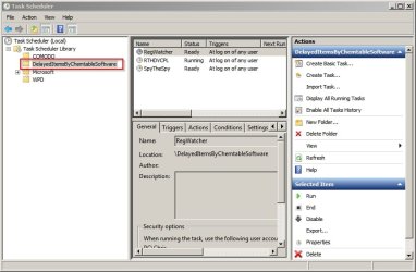

A new task will be created and is shown in Task Scheduler under "DelayedItemsByChemtableSofware"

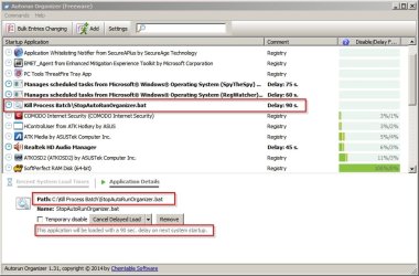

Unfotunately once Autorun Organizer has done it's job and all delayed startup items have launched it will leave a process running in the background - StartupCheckingService.exe
However you can actually use AutoRun Organizer to launch a delayed batch file to kill it's own running process.
Here's how:
Copy the following into notepad and save it somewhere handy as a batch file.
@echo off
TASKKILL /F /IM StartupCheckingService.exe
Add the batch file to the delayed startup list by adding it's file path.
Choose a sufficient delay - the batch file must run only after all other delayed items have launched.
