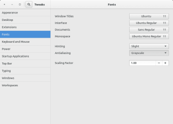

I found out the problem is subpixel antialiasing. I need to read up more on this one.

Can this be set to greyscale in windows and Chrome browsers?
I dual boot Ubuntu and windows 7.
I booted ubuntu, and went in gnome-tweak-tool. Looking at font settings found this, if set to 'greyscale' from 'Rgba', the color fringing entirely vanishes on Ubuntu system menus, but still exists on Chrome web browser text.
