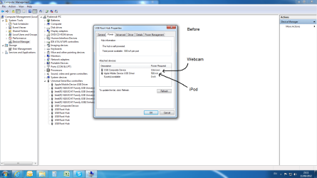

Bingo !!!

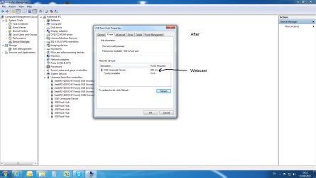

When both the WebCam and the Ipod are connected all 500 mA is taken by the WebCam and the Ipod gets None. (See Attach Files).
When only the Webcam is connected all 500 mA is taken by the Webcam. (See Attach Files).
That explain the issue.
But ... is it normal ?
