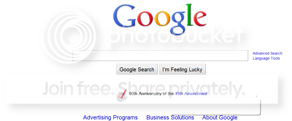

I have a "ghost" bubble, the kind you would see if a comic strip character were speaking, that's continuously in my lower right hand corner. Here's an image.
Any suggestions to get rid of that?
