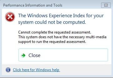

I can't run the WEI and get the following error shown in the attached file.
The contents of the winsat.log file is as follows:-
3346751 (3216) - winsat\logging.cpp:0815: --- START 2010\8\4 18:11:08 ---
3346767 (3216) - winsat\main.cpp:4301: Command Line = "C:\Windows\system32\winsat.exe" formal -cancelevent 1916a47b-99bb-4485-9563-ab8574650fbc
3346767 (3216) - winsat\processwinsaterror.cpp:0095: ERROR: tried to read resource strings, unknown exception occured
3346939 (3216) - winsat\main.cpp:4474: > IsFormal=TRUE IsMoobe=FALSE.
3346939 (3216) - winsat\main.cpp:4505: ERROR: no multi-media files, no MM support
3346939 (3216) - winsat\main.cpp:2861: > no need to restore power state (no saver object).
3346939 (3216) - winsat\main.cpp:2873: > Not necessary to reenable EMD cache.
3346939 (3216) - winsat\main.cpp:4909: > exit value = 10.
Would like acces to the Areo feature and hence the posting.
Apple won't help and I daren't tell MS that the hardware platform is MacMini.
Has anyone had a similar exprience?
Robert, Edinburgh:o

Found the Answer
The answer to this issue is the N version does not have Media Player installed. This by law in Europe.
Down load this from MS, install and the WEI will run OK. After this Windows Aero becomes avaialble.
Sorted !
Thanks for everyone's interest
Robert, Edinburgh
