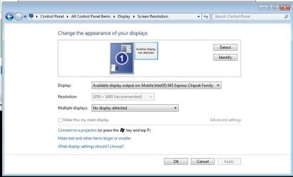

I get to "Screen Resolution" for the main screen only. Controls for the external monitor are greyed out.

Check in "Advanced settings", that screen refresh rate is correct for your monitor. Make sure you check the box "Hide modes that this monitor cannot display". If you clear this box, and select a mode the monitor cannot use, then you may damage it!!
