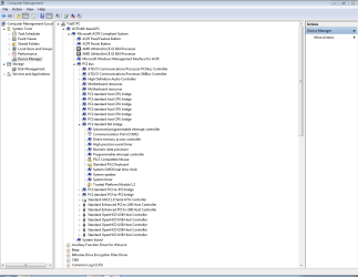

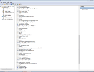

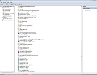

I have one of those baddies that takes over remotely by making your PC part of a domain and taking over SYSTEM and Trusted Installer. It also installs a hidden OS on the HDD, which DBAN didn't erase. I actually booted to it after the wipe, but couldn't get any credentials/user account to allow me to use/change anything.
A clean W7 install isn't a real install - it's a "spoof" version laid over their OS. If you try too many security/hardening settings changes, it locks you out of more and more access by graying out options. It loads its own versions of drivers, and I can't update even with offline mfgr. versions.
Here's Device Manager view By Connection:
Downloading various scan/fix tools to the desktop as recommended really doesn't work, because SYSTEM already has a spoof version it loads instead of the new file - all scans take about 6-30 seconds for a 250GB HDD. So...
Is there a way to make an absolutely secure USB stick on a clean PC with versions of these programs that run offline? A way that guarantees this malware can't hide on the USB stick?
Thanks, UberGoober

Thanks for replying to my post, ya'll! It's kind of you to volunteer to help us with our 'puter problems.
Respectfully, I really don't want to argue about whether I'm infected with a RAT (https://technet.microsoft.com/en-us/library/dd632947.aspx). Been there, done that (http://www.sevenforums.com/system-s...stalled-hidden-virtual-hd-os-c-partition.html). Let's just assume I'm correct that I'm infected, OK?
BTW, I already wrote and tried to post this reply, forgetting about the glitch where the "Post" button always redirects me to the sign-in page when I'm already signed in. So I lost my work. This time I'll copy it to note pad, sign in and try posting again.
I got A+ certification in 2011 just for my own edification, so I do understand all the doubts you've presented me with. I'll address the ones in your posts. Then we drop it and concentrate on a wipe solution and guaranteed secure USB stick, OK?
Got this PC from Newegg. It's a Joy Systems officially-refurbed HP 6005 Pro SFF with W7 Pro SP1. The disk sent with it is Microsoft-branded and labelled "Intended for distribution with a refurbished PC". HP, AMD, Broadcom, Realtek, etc. drivers used to load when installing from the disk, not all that garbage shown above, which cannot be changed, period. Any attempt to use a driver installer pkg. results in a huge, blinking "ERROR!" message, and a reboot is forced. That's why I'd like to try a secure USB offline install.
The mouse and keyboard driver alerts are one clue analysts use to detect a RAT - you can't update, roll back or install new ones. They are needed by some of the hundreds of Authorized Users allowed to log onto my PC remotely.
The boot menu screen always shows a PXE Boot Agent. I have to "Ctrl+S", save settings, then designate the boot device. The DVD drive spins, but what is actually installed is a restore of the Remote Admin's original setup, just like in your company domain.
Even with complete disconnection from the network and internet (I use Ethernet cables only), the original setup is restored. It has to come from somewhere on the HDD.
I've used DBAN since it only came on floppies. It's now on a CD I've used successfully on numerous HDDs people asked me to dispose of for them. After these wipes to my HDD, I still couldn't make a whole-HDD partition with DISKPART or any of my 3rd-party programs. Between 8 and 12 GB are missing when you do the math with 1,024 bits after each wipe.
Neither do the "clean" or "clean all" commands work, even using the hidden elevated admin account. And I reviewed everything very carefully all 3 times I tried - no syntax or spelling errors in my commands - yet the only response to "Enter" execution are error messages that there's no such command or syntax is wrong.
So, any ideas to get the drive fully wiped and/or create a truly secure USB stick?
Thanks for any efforts you invest for trying to help me - I tried to write in an upbeat, friendly tone, but don't know how it'll come across to ya'll on reading it. I honestly do appreciate it.
