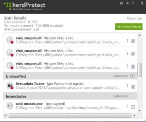

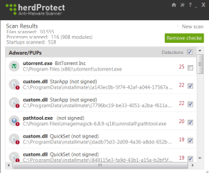

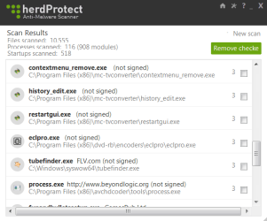

Yes it is an advanced tool, meant for someone to look at the log. Not just for anyone to install. Sorry If I did not make that clear at all. That was my fault. That does sound like a lot of items though, if you want I suggest creating a new thread and posting your log so I can take a look.
I had uninstalled the program yesterday and reinstalled it.
This scan took about 10 minutes and then said "failed" after finding 27 processes.
I ran it agin, but don't see a way to save a log.
It said 17 processes, but this is all I see.
I've included a pic.

I had a hard time finding this thread- the email sent me to the old one and I guess you moved this thread.
Here are the results after following your instructions and rerunning Herdprotect:
I don't see a way to to see the log - If I go to the folder, it just has the logs from yesterday.
I've not removed anything yet.
I also noticed that my C drive is now 9gbs less, even though I didn't do anything.
My PC is also running quite a bit faster - had no idea that so much garbage was slowing it down.!

What about the processes that Herd found - I didn't delete anything.

I don't use Herdprotect (it mostly found 'unsigned files').... let's see what Eset finds.
