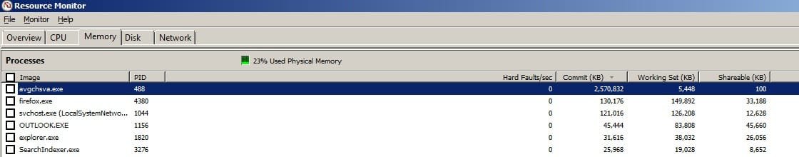

Seems like I have a similar problems here. I'm running on 7x64 Ultimate. Recently I installed AVG 9.0 and symptoms start to appear like what you have experienced.
Right after I boot my machine, it consumed 80% of my 4GB which in total is ~ 3GB. I could tell the cache from memory leak as before I had my AVG installed, a fresh reboot only results in about 1GB+ cached. I know Windows 7 isn't very aggressive on cache memory like Vista does.
I checked Recource Monitor and the process avgchsva.exe commits 2.5GB just right after fresh boot (take a look at my attachment for the screenshoot). Is that supposed to be normal ?? I hardly believe so.
Removing AVG brings the system back to "normal" state.
