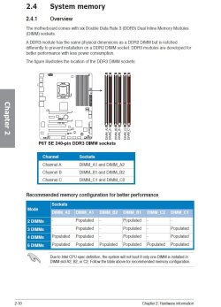

hmmm. i try slot 1,3,5. My system won't boot. Anyways, thanks alot guy, i guess 4gb is good enuff for me for now, i havnt got time to fix it yet..
windows7
Are you sure you put them in slot 1, 3, 5?
You only would have to take out the dimm from slot 2 and put it into slot 5.
If you give us the name and type of motherboard we can find out wich are nr 1, 3, 5 and what color they are.
Better to fill out your systems specs anyway.
MK2
7
yes, it an asus p6t se.... mine slot are black and redish orange...
windows7
According to the manual they should go into the orange slots.

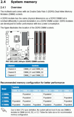

Ok I found this info about your memory and board.
Maybe one of our experts can advise you further.
Steve

thanks you soooo much guys, its work its work.. yay lol..
windows7
Glad we could be of help to you.
Steve

Glad to hear the news! :D
At least now you will know to go over the manual for any board when installing memory and didn't run into any real hardware issues.
