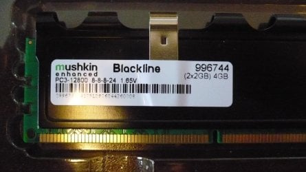

It depends on what model of RAM you have. Which one in that flyer is yours? Try pulling a RAM stick and looking for a tag or label, like mine has:
Notice the timings and voltage marked on the tag. Yours should have something similar on it, I would think.
