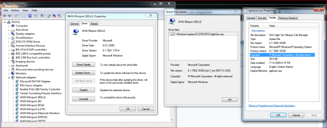

Well, I can certainly see a need for ethernet upon recovery. I'll try to find out how to add the missing driver to the Ghost recovery discs.

By the way, would anyone know where to get the driver? I would prefer to get it from a Toshiba or Microsoft site, but the laptop driver download page for my model at Toshiba Canada doesn't list anything containing "wan" or "miniport".
The thread WAN miniport ikev2, windows cannot load the driver - Pb for VPN connection how to transplant the relevant part of the registry, but I would like to avoid mucking with the registry if possible. I would feel much more confident about having a driver that can be installed by more conventional means (if there is such a thing).
Windows 7 Pro 64bit
1. the driver you are looking for you have to get from where you got your modem - e.g. your ISP. I doubt though that you need it.
2. As far as imaging goes, if you are comfortable with Ghost, use it by all means. But if you want to use an SSD, I suggest you only transfer the C partition and maybe the 100MB system partition (if you do not want to move the bootmgr from there to C). But with your images, there is no need to clutter up the SSD with the recovery partition and the tools partition. The Paragon Migration Tool is excellent for transferring C to the SSD. I use it all the time.
Good luck finding that driver anywhere other than from within Windows. It is included with Windows,
