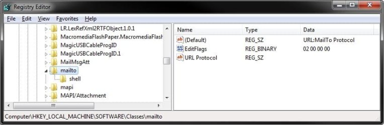

In my registry I'm missing the mailto portion of HKEY_LOCAL_MACHINE\Software\Classes\mailto and I'm wondering if I can create this by way of using edit/new when running regedit?

Hello Russell, and welcome to Seven Forums.
Did you scroll down past all of the file extensions listed at that registry location? mailto will be under all of the file extenstions in the protocol list like below.

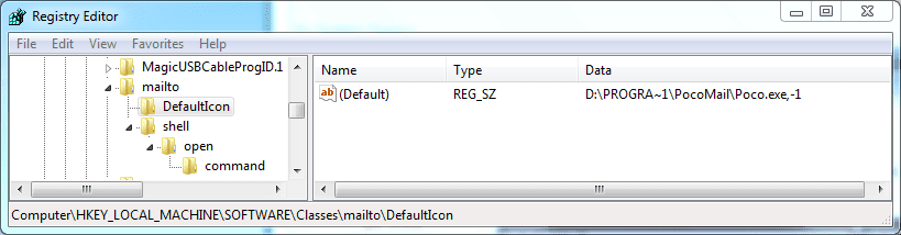

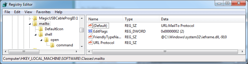

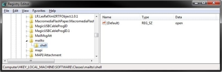

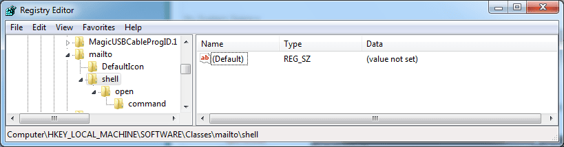

I'm attaching snips of the registry entries found under HKEY_LOCAL_MACHINE\Software\Classes\mailto just in the hope that someone may be able to say if there is a problem there to be fixed.

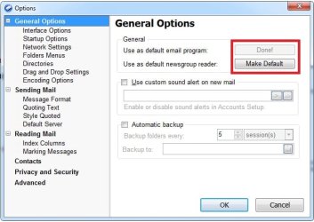

After you installed Pocomail, did you click on Tools -> Options in Pocomail, then click on both the Make Default buttons as below? Pocomail should also be available to select in this Default Programs.
I also installed Pocomail in a virtual machine, and extracted the defaiult MAILTO registry entries below for you If you like, download it, and double click on the .reg file approve and merge it to see if that may help afterwards.
Brink, the option to merge didn't come but a run option did, those entries are in the registry but will need editing as they show Poco in the C drive instead of D but I don't see this as difficult to overcome.

Yeah, try uninstalling and then installing Pocomail using the default installation settings and C: drive location to see if that may work. If not, then check to make sure Pocomail is set as default like in my screenshot above.
