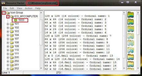

Hi guys, sorry to bring this post back from the dead but I am having the exact same issue. I used the same program and now my explorer icon looks like this:
Since all the image links tkwolf posted have expired I have no idea how he fixed the issue. Any help would be very appreciated.

Hey Arc, how do I get to that Change Icon menu?
Windows 7 Home Premium 32bit
Go to C:\windows\explorer.exe. Right click on it > properties. In properties window, click on the customization tab, and click on the change icon button.
It will give you the change icon dialog.

There doesn't seem to be a Customization tab.

That worked fine until I unpinned Explorer from my taskbar (I do not normally keep it pinned there). From looking at the icons in my SHELL32.dll it appears that the normal explorer icon has been corrupted, as shown:
I'm thinking this is the cause of the issue, is there any way to fix this?
