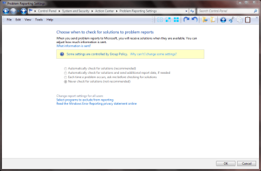

Somehow problem reporting has gone missing on my system. Not sure for how long. When I try to turn it back on it says that Group policy may have disabled it.
Considering this is a single PC running Home Premium with no GP editor how can I change this?

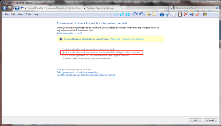

Post #1 you have (Never check for solutions) in the picture.
Try one of the others maybe the recommended.
They are greyed out and not selectable.

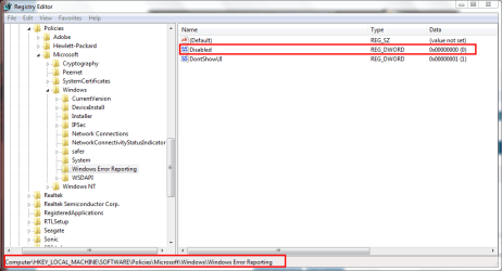

Well I have got half a fix. Selling the following registry key to zero enables WER.
Unfortunately I still can't change it through the control panel.
I had hoped that "Don't show UI" would do it if set to zero but no luck.

Kato
You would need to delete both the keys you find under
HKLM\SOFTWARE\Policies\Microsoft\Windows\WindowsErrorReporting
and reboot the system
You should be good to go.
Nothing specific....what ever the clients provide for Repair
Windows 7 ultimate x64
Thanks centaur that did it.
