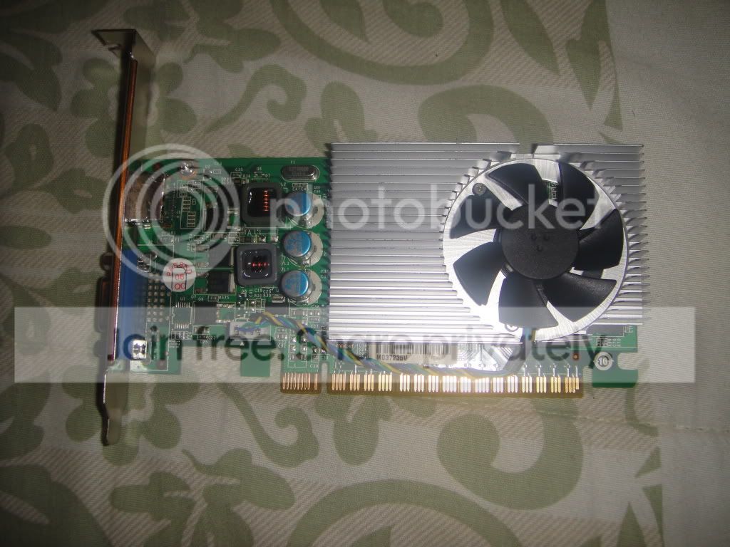

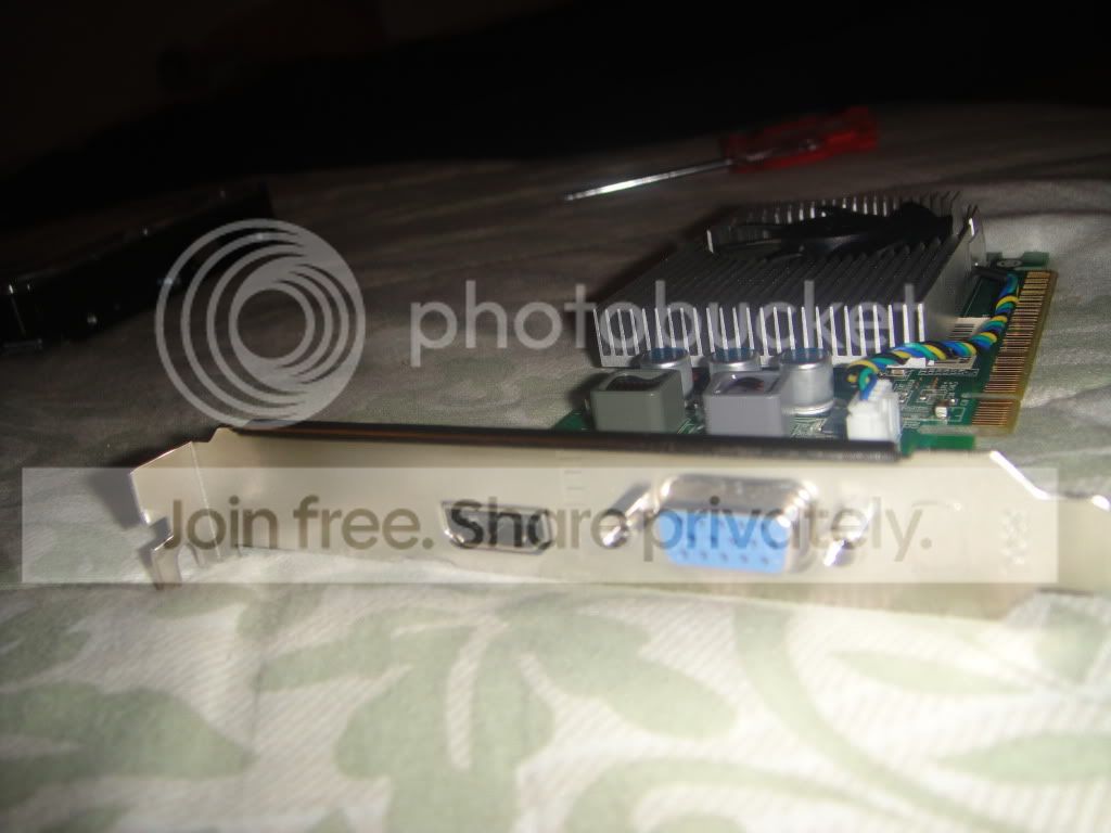

oh wow.. is defently the videocard my friend. and the only way you will find out for sure, is if you can put another videocard on it. does your board have the vga connection in case you remove your videocard?..
ps: heres the videocard that is defect it and is doing the samething as your descriptions
