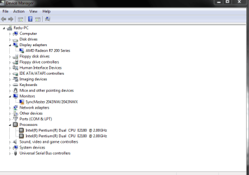

You might be able to force that resolution in CCC (Catalyst Control Center) AMD's driver in the custom resolution area, I don't know if it works for VGA though. Can you post a picture of the CCC you have installed, and your device manger please?

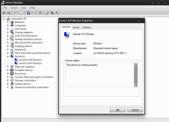

Yeah that's it, pick new then only change the stuff in base mode and put 1680x1050 and 60hz and hit apply and see if your monitor says its out of range or not. It should bring up a window that says if you cant see this screen it will revert in like ten seconds or something to that effect. EDIT: wait, the triangle on your monitor driver in device manger if you right click and hit properties what does it say is wrong with it?
