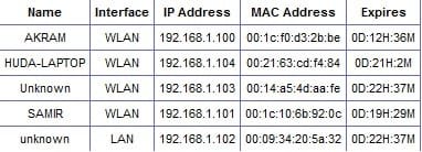

First I want to know who is using the network, just to make sure nobody is on the network that I don't know of. I have a linksys WRT54GC, yeah with the C in the end it means I cannot run the tomato firmware.
once I know who is on the network, I want to know what are they doing, like what applications are they using, normal browsing or torrent or whatever they are doing, and how much bandwidth they are taking, that's all.
I have done some searches on google, and it does seem possible if I can run the tomato firmware but I can't run it on the WRT54GC :( . if i logon to the WRT54GC administrator console through the browser, I can check the IP addresses that have been given through DHCP, and some of them I can't ping and not sure who they are... here is a pic that shows the info I can see, but this is all I can see. I cannot even ping some of the unknown ones, could be a firewall blocking the ping duno

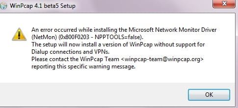

oh thanks how stupid of me, I already have a windows live ID! I misunderstood I thought your talking about something like technet lol thanks for the links guys.
also tried that Wireshark, v1.2 beta but it's a no go with Windows 7, I do have another PC i could try it with that's running XP though, so might do that, but since I can get a trial for Microsoft's own network monitor I will look into that first as it sounds promising!

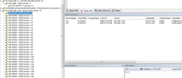

btw started playing around with microsoft network minotor 3.3, I noticed there is "My trafic" and "Other Trafic" sections, under "My trafic" I can see the applications that are on my PC that are using the net. on "other trafic" I can see the IP Addresses that are on the network, one of them I can't even ping but I can see some information on it, but not detailed, like I don't know what applications are being used and how much badwidth, here is a screen shot:
