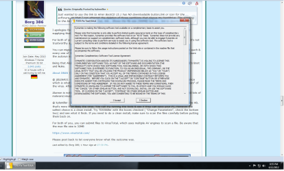

Thanks borg. Here's where I'm at with the two remaining programs.
TDSS:
I went back and tried doing the process over a couple more times and I couldn't find the 'Change Parameters' option. I attached the screenshots of what I have when using the program.
Step1: Accept the usual license agreement
Step2: Given the option to either Proceed or Close
Step3: Prompts for the reboot of my comp.
Is it possible that maybe the version petey linked is a different version than the one you originally suggested?

OK, I see what's going on. You're using the Norton Tool.
Go ahead & d/l Kaspersky TDSSKiller
Anti-rootkit utility TDSSKiller
This is the tool where you'll find the settings I described ('Change Parameters'). Click the two lower boxes. Go ahead & run that, if anything is left it'll inform you, follow the prompts. If it finds/cleans anything, reboot & I think you already have a copy of Windows Defender Offline, go ahead & run that to clean out any other viruses.
Try this tool 1st as it is the easiest and generally does the job.

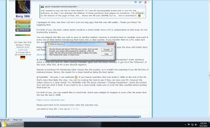

I've got the scanner all downloaded, and here is the results of the first scan. (Attached green photo)
I chose to Delete all four and about to to my reboot, then another reboot using Windows defender.

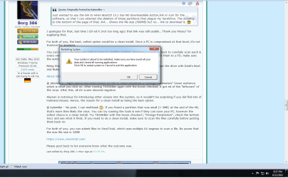

Edit #1: Also, upon start up, I now get this dialog box prompting the install of 'Solution Center'. I didn't install anything like that, so I'm a bit perplexed where it's coming from.
(Attached 2nd photo)
Edit #2: I've got the scans with both Windows defender all finished up, nothing detected/removed.

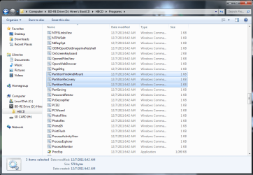

I do have a quick question about the HiRens process though. I checked out post #8 on the other page and see he was able to screencap and paste his results into Excel. When my HiRen boot is running it keeps me at the normal boot screen where I have all the partition options I listed a couple posts up.
When I go to select a partition, nothing of that nature showing the 'File System', 'Label', 'Size', 'Used', etc. shows up for me. All that happens is my computer starts to boot back up again.
Am I selecting the wrong partition perhaps? I copied and pasted my HiRen boot options from my previous post below:

Edit: #3: I did some more searching around the HiRen's when just inserted into my disc drive and found these three partition related programs in the 'Programs' folder.
I tried all three and the 'Partition Wizard' is the only one that will open. (Error on "PartitionFindandMount', and dead end on 'PartitionRecovery')

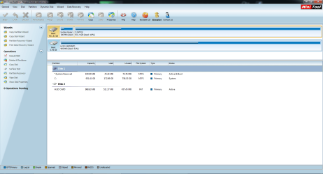

Am I on the right track with Partition Wizard? Attached is the screen it displays once opened....

Here is the utility to use, insert Hirens Boot Disk & launch GParted.
When it Launches "do not touch keymap" should be highlighted by default, hit enter.
On the next prompt, choose your language, then press enter.
Press enter again and the the GUI screen will launch.
Look for a small partition, marked as unknown or hidden. (See picture below).
This is the one you need to delete. Highlight it, hit the delete button on top and confirm the actions. If the partition is marked as Unallocated, then it has already been deleted by TDSSKiller.

From what I'm seeing it looks like TDSSKiller flagged the HP Solution Center files as suspicious. Those are easily restored, provided you use that service.
Still, the best & safest option would be to do a clean install. Like I mentioned, once a PC is compromised at that level, it's hard to know if it'll ever be safe again.

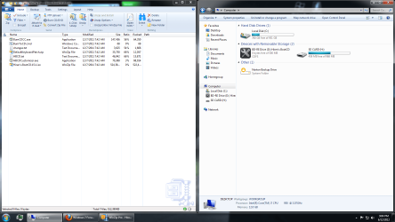

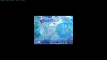

I've got GParted downloaded (It wasn't on the HiRen disk) however it won't install/open the scanner for some odd reason. I opened up the website link and downloaded using the 'Looking for the Latest Version' link, as well as trying the 'gparted-live-stable' version as well.

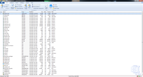

I attached a screenshot of what I have when viewing the file with WinZip.
The only .exe file is at the top and when I click on it and hit 'Run' the box disappears, then reappears. The second time I click it, I get a quick flash of what looks like a black command prompt screen, and then I'm back to square one.
For the Autoplay, I disabled that using the SevenForums link you posted on page 2 but I did a large majority of my downloading and transferring of the 'clean downloaded' AV scanners using that card.
Should I just keep using that card for these last few steps if I need to transfer over another AV scanner? Or just download everything from here on the infected desktop?
Edit#1: I also tried downloading it on my laptop and burning it to a disc with no success. After looking around on the disk, it seems as if this program is called 'Gnome' instead of GParted. I attached a screenshot of one of the PNG files in the 'boot' folder...

You have the right file, Gparted is a boot disk, once it's burned, insert it into your drive, reboot your PC & it will run. Then follow the directions above.
The file is an ISO, once d/l ed, double click on the file & your burning software should take over & burn it. If you d/l ed the zip, just extract it on your PC & burn it to disk.
Since you disabled the auto run, go ahead & keep using the card. You should however, scan it thoroughly with MSE & Malwarebytes

I apologize for the delay borg. Anyways, here's what I've got at the moment.
I got the GParted disc all burned and did the re-boot with the program. I wasn't able to screen cap so I took a photo of the screen instead. :geek:
It didn't seem like there was anything suspicious or a partition titled 'unknown' like in the case a couple posts above, so I didn't delete anything as I wanted to double check with you first.
As for the other virus scans, Malwarebytes doesn't have anything showing up on any of it's scans I'm doing and nor does MSE.

No problems on the delay. It looks like you got it, I see the small partition there (typical of Alureon) and it's unallocated.
You may want to run TDSSKiller one more time to be double sure.
Run a scan with MS Defender Offline (Boot Disk) to make sure no other viruses are left, then boot to windows & run a full system scan with Malwarebytes, MSE & SuperAntiSpyware.
Keep a close eye on your PC & it's behaviors. Anything suspicious actions should be investigated immediately. You may want to take this opportunity to back up your personal files. And make sure to run a scan on your SD card with all of the AV's.
Hopefully, your PC is clean. As I mentioned earlier, the safest thing would be a clean install, but you can do that down the road if you choose, once you have your files backed up. If after all these actions taken, you find your PC still has problems, a clean install is the only option left to thoroughly rid it of the problem.
As for the Solution Center, that's your choice to re-install or not. If you don't use it for anything, then you might want to consider uninstalling it all the way.
Also, consider running a SFC in case any files need to be fixed.
It's recommended that you run it 3 times as it doesn't always fix everything on the first pass.
