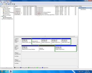

Hello there, I have a situation and I need some help.
On a system with 2 HDD's (please find attached print screen) I just wanted to know how can I remove without any boot problems, the SYSTEM G: partition which is a sector by sector clone of SYSTEM D: made by EaseUS Todo Backup partition tool in order to have a final scheme like :
Disk0 : Win7 x64 drive C: , Database D,E,F
Disk1 : System (XP) drive G: ,Database H,K
As far as we can see, the drive D it's found as a System in the status field.Not so sure why the clone of this drive , is not found as a System too...
Second, I'm not sure if the Win 7 is started by boot files/sequences found on drive D.
If help, the bootloader listing looks like this :
There are a total of 3 entries listed in the bootloader.

Should I edit somehow the bootloader to avoid any future problems if I remove the drive D ?
Please ignore the unallocated space, the free space will be realocated.

If G is a bootable XP OS (which you don't say for sure) then it is indeed booting off of D since it doesn't have its own System flag. So it can be deleted in Disk Mgmt and have the entire space created into a new Partition.
The partitioning is very messy with a 50gb System partiition which is typically only 100-200mb - was this previously a System Recovery partition? - and the rest including Win7 all collected into an extended Logical partition.
You should consider moving the data off to wipe the HD and competently reinstall Win7 to the first partition closest to the disk reader for faster read/writes.

*regarding the G partition ,as I've mentioned earlier, this is a clone of D but ,as we can see in computer management status field , without boot sequence (not so sure why is that) - this is the reason why I am afraid to erase the system, active drive D.
*regarding the size, I've made that 50G's system partition (D,G,C) thinking about filling the program files with large apps.The rest of the partitions is it true, are made only for storage (E,F,K, etc)
Is it ok to make a Primary system partition of a few Gb's and after that to install apps on extended logical "next to" ...partitions ?
*moving the data off to wipe the HD and competently reinstall Windows 7 will be the last solution because in this moment I don't have a backup HDD to save the whole data.That's why I am trying to reach this config :
Disk 0 : moving the Win7 at the beginning of the HDD (partition C: ) and after that ,data storage partitions D,E,F. Disk 1: as I 've mentioned System (XP) drive G: ,Database H,K.
I've read these posts but I can't find sisparv6.cmd (perhaps this can be a good solution).Also I have read about Startup repair in Win 7 and but something is missing .I can't make partition D and G inactive ,in order to be able to run Startup repair for Win 7 Partition.
By the way ,do you have any idea why there is no 100MB on my HDD partition made by Win7 for boot sequence? This is not always a "must have" ?

Both Win7 and XP are booted off of D. The idea of making it larger to install Programs is not a good one as Programs write registry keys that integrate themselves into the OS so should be on the OS partition.
There is no 100mb System Reserved partition because the disk was already partitioned when you installed Win7 to the partition way over at the right end away from the disk reader, apparently choosing to put its boot files on a 50gb partition which serves no purpose except to put the boot files at risk since it has a drive letter which such a partition should not. Did you even think to ask before doing any of this goofyness?
Your idea to move Win7 over to D after backing up its data would be the best. Use a flexible imaging program like Macrium - Image your system using its boot disk to reimage the stored image to the deleted space of D - selecting during the reimaging process to make it a Primary partition C. Then Mark Partition Active to run Startup Repair up to 3 separate times. Once the newly imaged Win7 starts up and is labeled System Active you can delete C and use its space.

I guess there is a misunderstood :) The drive D (System) is the drive with XP on it, I've renamed it, when I've Installed the OS on it and there was only this HDD (System partition - XP - and Databases.
This is not the Win7 SYSTEM partition.There are Programs installed on C: Win7 (x64) applications and also there are apps installed on XP (D drive) which become (C) drive when I choose to enter in XP.
That make sense ? :)
LE: the drive G also it's a database partition
win7 x64
In your first post you said quite clearly that XP was on G on DISK1. Did you reinstall it to D partiiton on Disk0?
If so and D is XP then it is also booting Win7 as signified by it's System Active flag.
This configuration is fine as long as performance is good and it's booting correctly with the booted OS showing as C.
