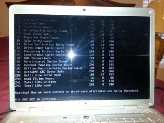

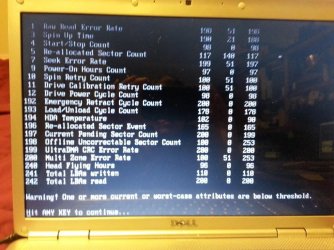

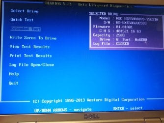

The only results I saw are the HD SMART data which is not normally reported by a HD extended CD scan. It instead scans each sector and reports its condition. What Extended scan are you running? It needs to be run from the disk.
Maybe your scan can't proceed if you're sure you've run the Extended scan. Can we see some pictures of how the extended scan transpires?
If these tests are failing as the SMART data test seems to report, and format can't seem to complete which may mean it has too many bad sectors to quarantine, then you'll need to replace your HD.
