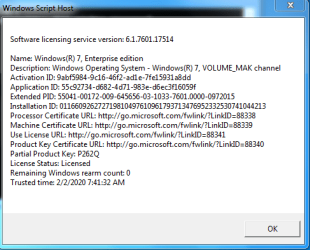

I was able to run both suggestions The first one had a copy feature but it did not work so in both cases I had to use the Snip tool then copy and past the results of that due the additional problem I have that if I attempt to attache something to a message my browser closes. Any way both results are below. I also read the Local Group Policy info you suggested and I don't really understand the implications of that subject although I could easily follow the directions.

can you tell me from the MS tool your info here
Windows Product ID Type: 2
Windows License Type: OEM SLP
and here, are they the same as mine, last block of numbers, just tells me the servers its going to
Processor Certificate URL: http://go.microsoft.com/fwlink/?LinkID=88338
Machine Certificate URL: http://go.microsoft.com/fwlink/?LinkID=88339
Use License URL: http://go.microsoft.com/fwlink/?LinkID=88341
Product Key Certificate URL: http://go.microsoft.com/fwlink/?LinkID=88340
IF there different DO NOT post them.

Product ID Type: 6 - Volume MAK
Windows License Type: There is no heading like this or anything with OEM SLP in it
My numbers are the same as those you listed

Here it is sent from different computer
