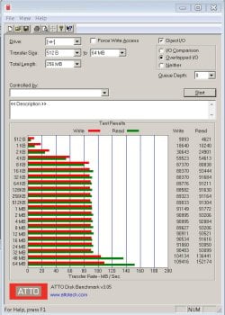

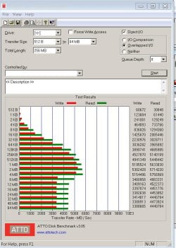

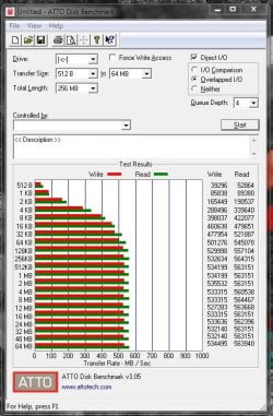

Here they are. C is the 840, E is the 950. Any help interpreting them would be very much appreciated.
I see the rate of the 950 starts going up at the 64 Mb transfer size point. Should I up that upper limit to get a better comparison? To be honest, I don't know how that influences the result. I have a lot to learn.

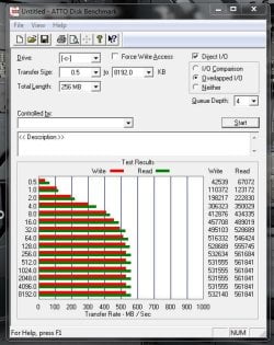

Both of your results look strange compared to my 850 Pro results, but I`m using a pic from older software, but not too old I just built this PC within the last 6 months.
I`m running the test with the same software you used, I`ll post a pic in a minute.
WHS knows how to read these results, I haven`t seen him here lately, but send him a PM

My results, Not sure why you`re getting such different results, you didn`t change anything with the benchmark did you ?

Is this the 950 Pro you have ?
Access Denied
Do you have your 840 Evo connected to an Intel sata port ?
And I don`t think you can change the upper limit, at least I can`t go past 64 MB
Also, fix your memory capacity in your System specs, you have 32 MB there.
You also have your CPU listed wrong.

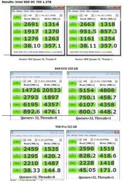

[FONT=&quot]In order to compare my disc speeds to a known source, I went to the Crystal Diskmark website* and clipped out their Intel 750 example test result and pasted it into a Photoshop image. Then I ran the same benchmark on each of my drives- same queues, same threads- and after each test, I used a snipping tool to capture the result and pasted it side-by-side below 750 test for comparison.
[/FONT]
[FONT=&quot]Before anyone suggests that these results could be faked, let me just say I wouldn't disrespect the forum by doing such a thing, even if I knew how. It's just cut and paste; no manipulation.[/FONT]
[FONT=&quot]As you can see, the 950 Pro pretty much held its own against the Intel 750, but the 840 EVO seemingly, (and I stress seemingly) way outperformed it [/FONT][FONT=&quot] by it is much as 20 times in the case of 4K reads. I'm under no illusion that I this is the fastest SSD in the universe, but either a driver or controller, or maybe quantum foam, is messing with me. Anyone have a recommendation?[/FONT]

Toy264, it looks like you have Rapid mode turned on with your 840 Pro. Rapid sets up basically a ram disk. The tests measure the Ram disk, not the SSD.

*Forehead slap* Thank you!
