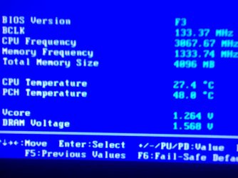

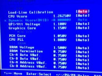

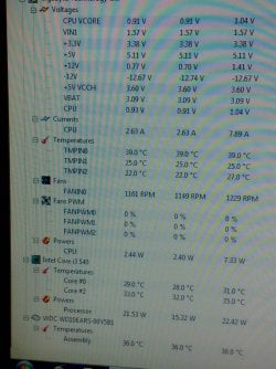

these photo showin voltage readings from bios an hwcp monitor

My first guess would be a faulty power supply. If you have access to a multi-tester, you should test this first.

and my hdd temp now is 36

Those temperatures are OK.
Hard drives in PCs usually run at temps between the low 30s and low 40s.
