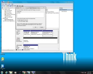

Please help me. I have a 1 TB WD external hard drive. It is of my passport series. Its age is 5 years old. It was working fine, one day when browsing through it, the cable came loose. And then the problem has been persistent all of a sudden. When connected, if I open disk management, it says "you must initialize a disk..." But MBR and GPT both styles fails to initialize. In disk management, my disk in unknown, not initialized, unallocated. I dont care much about the data in there, but I want to make it working again. If possible, recovering data is best, but if not, losing data does not trouble me much.

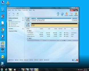

I tried using MiniTool Partition Wizard but it is not much of help. It says (Bad Disk).
When i connect to pc, the sound beeps and I can feel the spinning sound from the hd. But its not shown in file explorer. Previously, when i connect my hd, it used to say "you must format the disk" and used to be visible in file explorer. But after i tried formatting(but with no gain), it is not visible in computer.
I will be posting all the screen shots.
Thanks in advance.

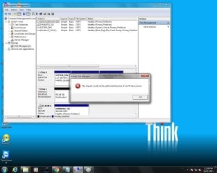

The I/O device error is a very serious one, including when another software is showing the drive as a Bad Disk and Disk Management – as Unallocated. You could try with another cable on both USB 2.0 and USB 3.0, see if you could clone the drive to try and recover the data later. Keep in mind that this could cause more damage to both the drive and the data!

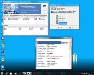

I have done diskpart and diagnostics. Both with no luck. I will post the screenshots.

As I suspected the drive has failed, I was going to suggest the DLG after all is done from my first post, but it's fine that you did it anyways. At this point if you would like your data back, you will have to recover it either using a software or professional services. The latter is more likely at this point, as the drive seems to be too damaged to handle data recovery in home environment. Otherwise WD has data recovery partners: Support Answers.

It seems to have severe damage. The DLG reports too many bad sectors. Once they occur and malfunction the device, that's pretty much it. :(
How old is the drive, did you check if its really out of warranty?
If your data is available for recovery then it could be done by professional in the best case, as the device at this point emits too any errors and is unrecognizable even in DLG. :/
