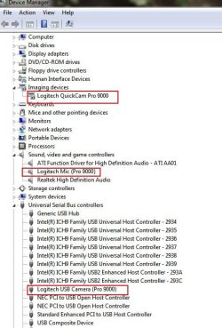

The old Logitech Webcam drivers and RC 7100 problem.... a search before trying would have helped you out....
If you can manage to uninstall it I suggest upgrading to at least v7232 before trying again ot just wait and install the RTM by whatever means.
With the camera plugged in you can go to CONTROL PANEL>PROGRAM FEATURES and uninstall any software related to the camera.
Then open DEVICE MANAGER and uninstall 3 devices
Unplug the camera and reboot.​
Run CCeaner and clean the registry,​
You can then do an inplace upgrade to 7232 ot later and attempt to re-install with the "correct" driver which may be the one you tried to use with 7100.​
Which driver did you try to install?​
OR....​
Restore your system as already suggested (much easier).​
