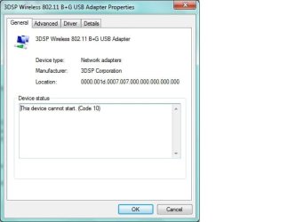

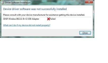

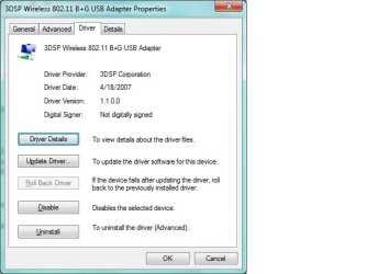

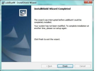

I have an Asprie One dual booting XP and Win7 RC1. I also have a 3DSP BlueW2310 combo card (WiFi+BT, mini pci-e) that works fine under XP with the supplied XP/Vista drivers. However, Win7 will not successfully install the hardware drivers. Have contacted 3DSP (US and China) and have to date received no reply as to when there may be Win7 drivers for this card.
I have attached the screen shots of the install error and device manager information on the card. If anyone has successfully installed a card like this in Win7, I sure would like to know the procedure you used.
Thanks.

if the Vista driver works after upgrade to Win7, then it seems to be a installer problem, and not a driver problem.
Try rightclick on the setup.exe, go to properties and select Vista SP1 compatibility mode.
Now close the dialog and doubleclick the setup.exe.
Hope it works.

Hi, I Tried all compatibility modes before reinstall w7 but dont work, driver manage to install but at the end windows say than cant install the hardware. Same issue with the pci card 3DSP. Regards
