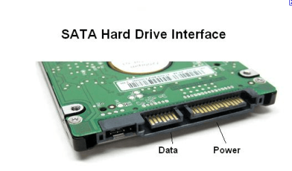

What is SATA or Serial ATA?

Yes it has two SATA-2 3.0Gbs ports on the mother board for the hard drive you listed in post #1 to plug into.

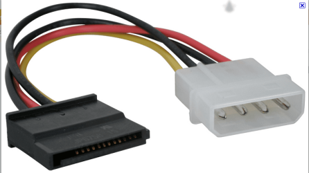

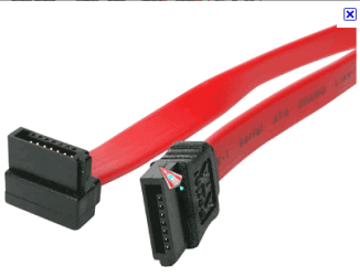

You will need a power cable and a data cable like Brianzion posted.
They are not included with the hard drive.
ECS Web Site
Data cable.

sata power cable
