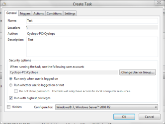

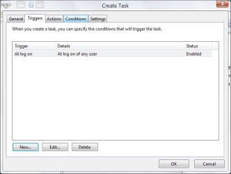

Try this with Task Scheduler.
Open Task Scheduler (may need to provide administrative credentials if not opened from within an administrator account).
Click Create Task...
This will open the following dialogue panel, with the General tab selected. Give the task a suitable Name and Description. Also, change the other settings (if different) to match those shown below.
Click the Triggers tab and then click New...
Enter the settings as shown below (you can set the date to whatever you want) and click OK.
Click the Actions tab and then click New...
Enter the settings as shown below (note that you can change the message to whatever you want it to display) and click OK.
Since we don't need to change any further settings, click on OK to finish creating the task.
Click Task Scheduler Library to bring up the list of tasks, highlight the one you've just created and click Run to test it.
The task will now run at log-on on and after the date specified

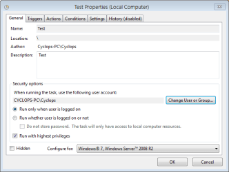

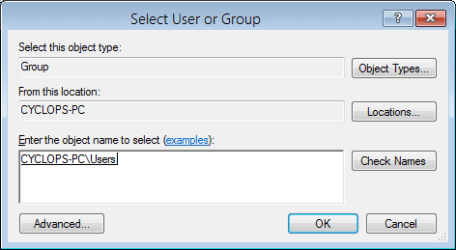

OK. I think I've got it. Open Task Scheduler, click Task Scheduler Library to bring up the list of tasks, highlight the one you've just created and click Properties to bring up the following dialogue.

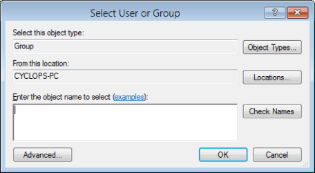

We need to change the information under When running this task, use the following user account:, so click on Change User or Group...

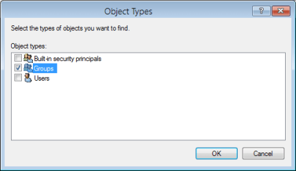

Click Object Types... and change the settings so that only Groups is selected, as shown below. (Note that this is optional, it only narrows down the list you have to look through in the next step. If you wish to omit this step, click on Advanced instead and move on to the next step.)
Click OK.

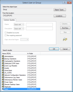

Click Advanced... and then click Find Now. This will bring up a list of items that match the search criteria. Scroll through and highlight Users as shown below.
Click OK.

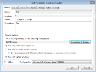

Click OK. If the next dialogue comes up as shown below, you have been successful. If not, review the above steps to ensure that you haven't missed anything.
Click OK to save the task, and close the Task Scheduler. Regardless of the user logging on, this task will execute and s/he will see the results of it on their screen in their account.
