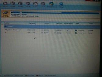

offline defender couldn't start up - saying something about not being able to access the system files. i booted up with partition wizard and at first it kept stopping me, giving an error about not working on windows server (except i don't have windows server, i have windows 7 32b), but after i changed the boot order and hard booted, it came up and i rebuilt the MBR. the 100mb is set to active and the c: was also set to active (however it didn't say c: for the description....was just blank, but gave the correct filesizes for the drive). i am now in the process of startup repair x3, and it looks like this might take a while.

i attached a picture i took of the pw map

Is this your only HD or did you already unplug one? If so plug it back in and take another snap to post back. I'm wondering why there are no flags on what should be the OS partition. Have you done anything to it at all?
CLick on HD in PW to highlight it, from Disk tab select REbuild MBR, Apply. Does it start now?
If not try running Startup Repair 3 separate times with reboots the way it is.

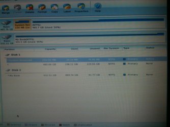

i am giving you the new snapshot first, before i go and rebuild MBR again

It's very unusual there are no flags on the Win7 partition and hence no evidence it's even installed there. Did you do anything with the PW CD or otherwise that might have affected the OS?
So if you try to repair it with Rebuild followed by 3 Startup Repairs and it won't Repair, browse in with the rescue disk to see if you can rescue your files. If so then you might want to try more of the steps in Troubleshooting Windows 7 Failure to Boot. If not you can skip to Clean Reinstall - Factory OEM Windows 7
