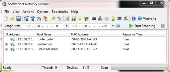

What would be the best? I built my network myself and there are no known IP conflicts.
So, some type of network scanner to see what mac is using what IP..

As for an IP Scanner. Angry IP is very simple and effective:
Angry IP Scanner : Home - IP and Port Scanner Tool for Analyzing Networks
