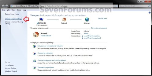

4. Click/tap on the Change adapter settings link, and do step 5 or 6 below for what you would like to do. (see screenshot below)

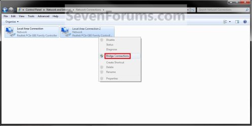

B) Release the CTRL key, then right click on one of the selected network connections, and click/tap on Bridge Connections. (see screenshot below)

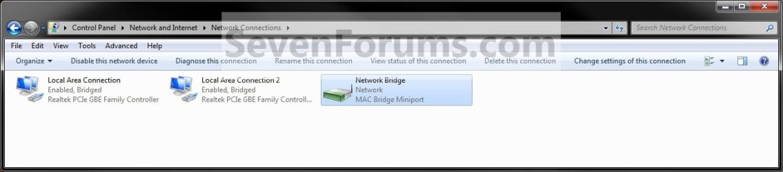

D) After a moment, you will now have a network bridge of the selected network connections. Go to step 7 below. (see screenshot below)

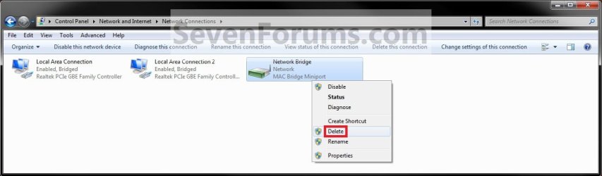

A) Right click on the Network Bridge, and click/tap on Delete. (see screenshot below)

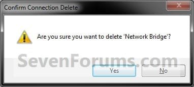

B) Click/tap on Yes. (see screenshot below)

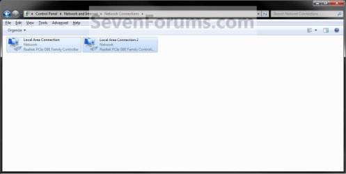

D) After a moment, the network bridge will be deleted and removed. Go to step 7 below. (see screenshot below)
