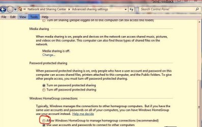

Do you have this selected or not?

Yes it is sellected. I assume I dont want it selected?

Yes it is selected. I assume I don't want it selected?
I am not sure about that I do not use home groups. Nor do I stream music. I suggested that as a place to experiment with your share settings. It seems that if it worked before then it should work now unless the finished product is conflicting with the beta's. Good luck to you.
